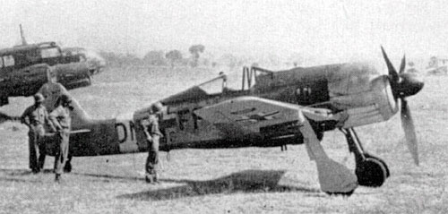

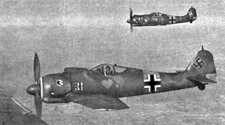

See here for another Airfix 190 build:
http://www.graf-gris...l/fw190graf.htm
Note that he says "5mm"... and he says that he added that length to the cowling rather than re-work the engine mounts and whatnot. However, I think his cooling fan is still too close to the cowling ring. I think you'd need a bit more than 5mm to make it look "right."
Which made me think about things... The A-5 (and later) models added a 6" extension forward of the wing leading edge, in front of the engine. What if Airfix modeled the A-4/A-3 exterior, but forgot that the A-5/later had that extra plug put in place?
In 1/24th scale, 6" comes out between 6 and 7mm, which would look a little better than the build in the link I posted above.
Looking at the built-up kit, it definitely looks like an A-4 or earlier model. A-5 and later models have this double panel line between the wing leading edge and the cowling, most times.
Example:
A-4:
A-5:
Airfix kit:
Looks like an A-4 fuselage, with an A-5 engine mount!! Note also the "cheek bulges" are moved forward on the A-5/later as well. That's a key clue that the Airfix is the early version, as they extend past the wing leading edge quite a bit!

Mark, something is definitely up with the business end of this fuselage. Here's a quick pic I took before I marked out the cut lines:
It has all the panel lines of the 15cm extension that the A-5 had. I'm thinking the best way to figure this one out is print out 1/24 scale fuselage line drawings of the A-5, -6, -7, or -8 and find where the deviations are.
I must say though Mark, you Sir, are definitely wise in the ways of the -190's.

Mark,
Well, it's not as easy as the business end of the fuselage. Using this diagram of the A-5 through to -9... I spent some time measuring out the fuselage panels while the little guy was sleeping through his afternoon nap. Here's the diagram (much smaller than the real thing - photobucket just wont let me make it bigger...):
Turns out that Airfix really did their homework on this one - the panels are bang on. REALLY accurate panel lines put in. So, I thought maybe the firewall mounts too far forward - Nope! It's also bang on where it's supposed to be. So, it's one of two things I think (or a combination of both):
1. The engine is to large (length wise (especially between the rows of cylinders)), and
2. The engine mounts are too long (as you suggested Mark).
Other than that, the fuselage has all the right panel lines and spacing. (I didn't count the rivets here, but simply measured out the lengths between the main panel lines. So, when I get a chance later on I'll measure out the engine mounts and that should really answer the question.

Okay, great news, I found out where this BMW 801 ends up growing too long on us... so, in trying to find where the heck the engine grew an extra 6 mm's (seems small, but Marks right, the cooling fan shouldn't be protruding past the front of the cowel)
1 - The spacing between the cylinder rows is a bit long - comes out to being a 1.5 mm too long. No problem, it'll be shaved down a bit inbetween the two rows.
2 - The engine mounts - the mounts themselves are fine... by themselves... but they don't sink into the firewall or the engine mount ring, the pin sinks in and the engine mounts sit ontop of them. Couldn't figure this out for the life of me until I was dry fitting it... go figure, shaving it a bit down and getting the fit right works - 2 mm's on both sides get taken off... right there, there's the 6 mm's.
Researching this is half the fun of the build - learning the history of the aircraft, the insides and outsides of it. So, figured that problem out - (thanks to Mark for helping me with this one). THIS is going to be a really fun build. The Stuka's really a great kit for the reasons I'm building it, and it's a joy. The -190, ohhhh, I'm having a hard, very difficult time, not starting this one right now!
